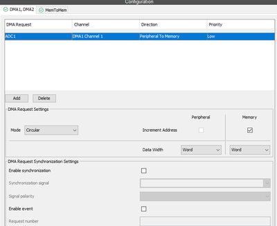

DMA is configured like this at the moment:
Since STM32 is a 32-bit MCU, WORD means uint32_t, I think... It is correct?
Yes, PA1 and PA3 are connected together. Not directly on Nucleo, but on carrier board. The is a voltage divider (5v to 3.3), then buffer and then NUCLEO. AI've applied 3.3v from NUCLEO to both input pins, after voltage diviers and buffers, I get 2.15v on BOTH pins of NUCLEO. So, the hardware should be okay, because the get the same voltage.
No, SB15 is still default, so not "installed".
@MM..1Okay, I've removed & , the DMA is configured as word, not half-word.

2024-10-12 6:56 AM
If DMA configured as Word_Peripheral- Word_Memory, than
uint32_t adc_convertions[5] = {0}; or int32_t adc_convertions[5] = {0};
correct declaration.
For Halfword_Peripheral- Halfword_Memory, than
uint16_t adc_convertions[5] = {0}; or int16_t adc_convertions[5] = {0};
2024-10-12 7:23 AM
Okay, then it was correct.
I've changed them back to uint32_t adc_convertions[5] = {0};
and:
I'll test with SB14 closed today evening.
