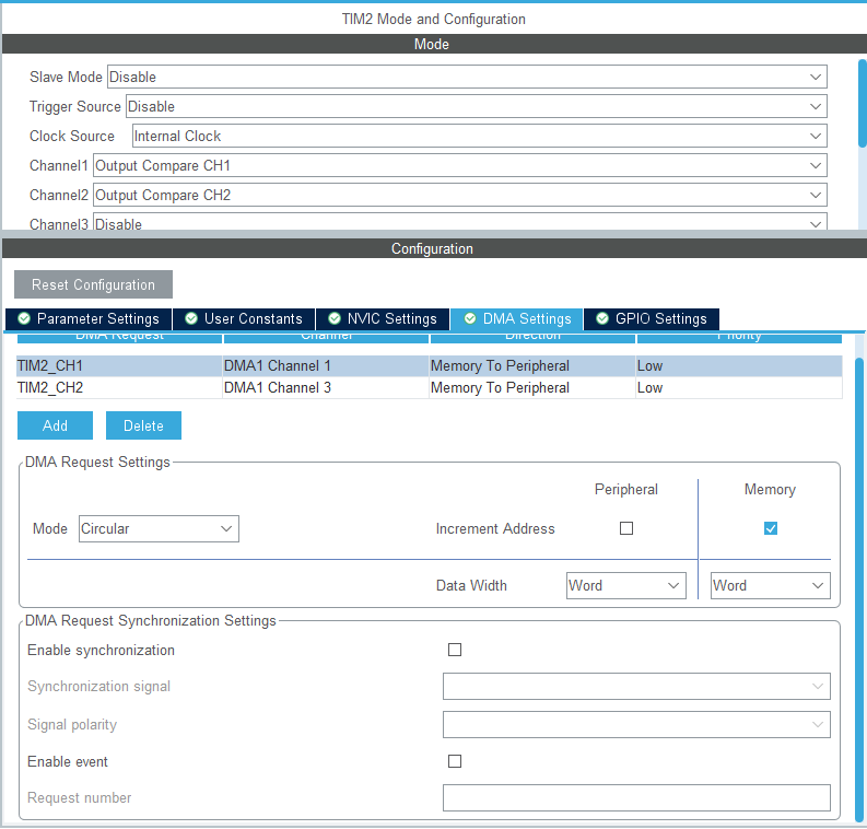

I have also configured the DMA to help switch the CCRx output compare value in order to go from low to high, and high to low again within a each timer period. At least that is want I want to achieve.

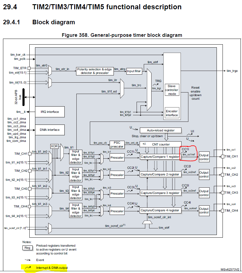

According to the STM32G4 reference manual, it look like the DMA request should happen after a compare as I expect but not how it is happening?

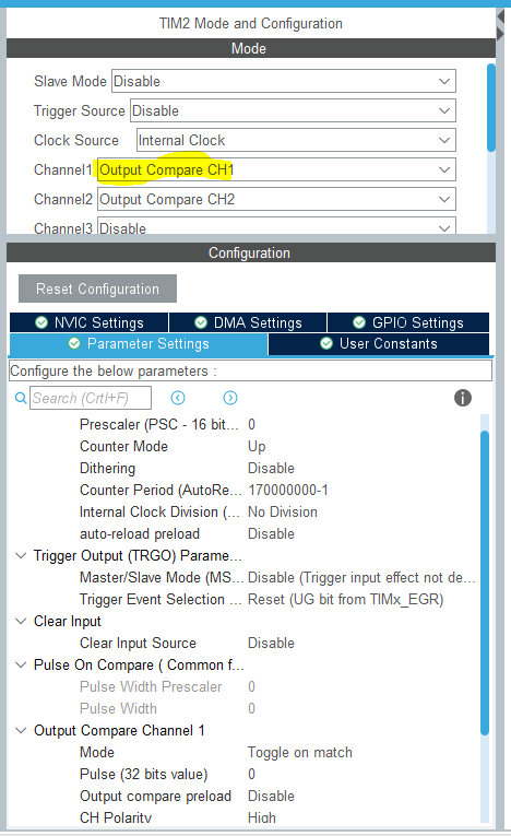

My timer CUBEMX configuration is as following. The system clock is set maximum 170MHz. Prescale set 0, period is set 170000000-1, so I expect the square puls to be generate 1 time per second. Instead it is generate everyother second.0693W000007C6vyQAC.png0693W000007C6wNQAS.png0693W000007C6wwQAC.pngThis is my code initialization of the timer with the DMA buffer:

You set the mode "toggle on match". So, every second the signal is toggled --> 0.5 Hz.
