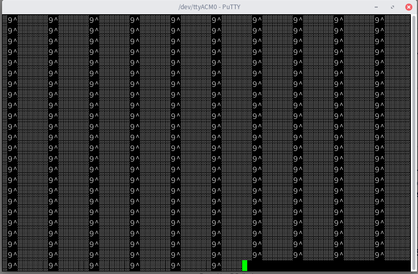

I've programmed this board to print out some data via the onboard serial interface (using UART2). But all I get is garbage characters, and I can't figure out why. I checked the baud rate of both the Nucleo and the terminal, I've tried different terminal apps, even swapped cables, but it still acts like the baut rate is mismatched between the two.

2021-12-03 2:07 AM
7-bit, really?
For clock mismatch check HSE_VALUE define.
