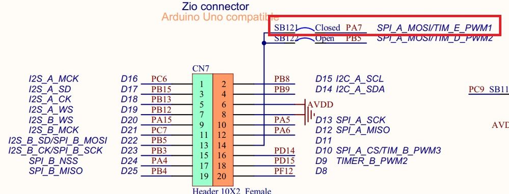

2023-12-19 1:27 PM - edited 2023-12-19 1:38 PM
Thank you TDK,
In the link you send me, in the MB1137 PDF - "nucleo-144 for everything" the text on the schematic around the arduino connector is misleading x(
I changed the pins allocations and now it works fine!
where do I find the schematic for nucleo-f756ZG ???
2023-12-19 2:02 PM - edited 2023-12-19 2:03 PM
What is misleading about it? I see you have posted a screenshot with a red rectangle, but I see no issue with what's in the rectangle.
I posted the link in my last response.
