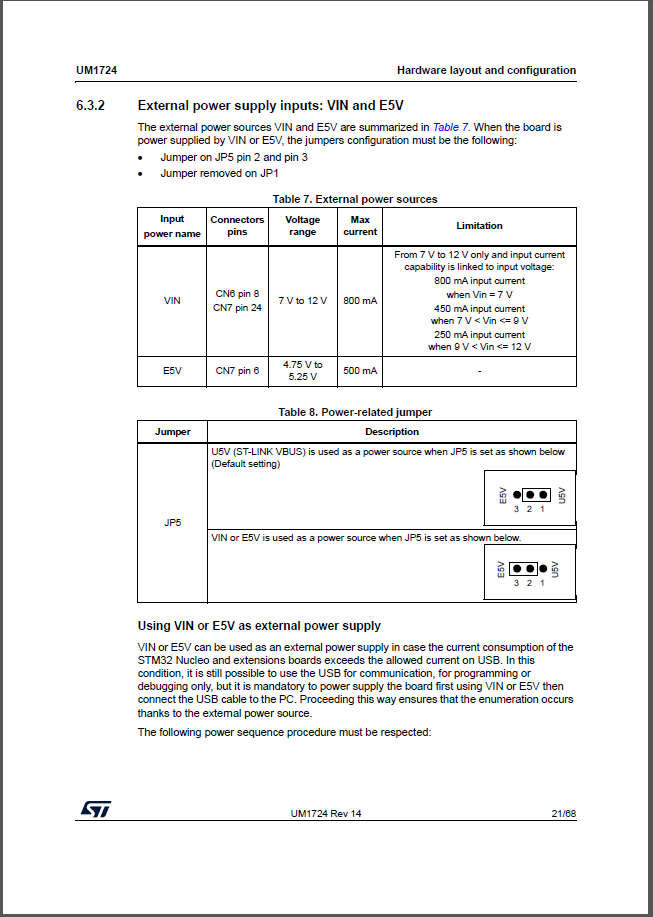

you can connect external power in many ways from an AC/DC converter you do not need any resistors or capacitors
see UM1724 User manual
