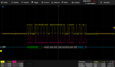

My apologies...I used the oscilloscope probes instead of the logic probes and now I see both CAN_H and CAN_L signals as I would expect. I am still new to CAN and I wasn't aware that the "zero" for CAN is actually 2.5V...with that in mind here is the CAN_H and CAN_L with the decoded message coming from the Nucleo board:
As for why the motor is not responding I believe I may have to take that up with the motor manufacturer. Thank you for your assistance!

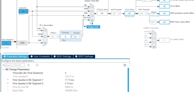

I suggest this config for the system clock and CAN at 500kb/s
Please check the availability of the 8Mhz on SB50 with an oscilloscope.
