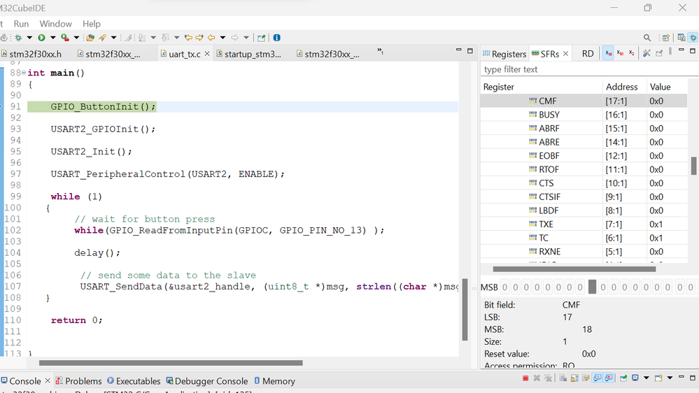

2023-11-04 7:11 PM
I have found something, why when I just click Start debugging, the TXE Flag is already SET? The program is not yet executed even 1 line. Does that mean the communication is taken over by other process?
