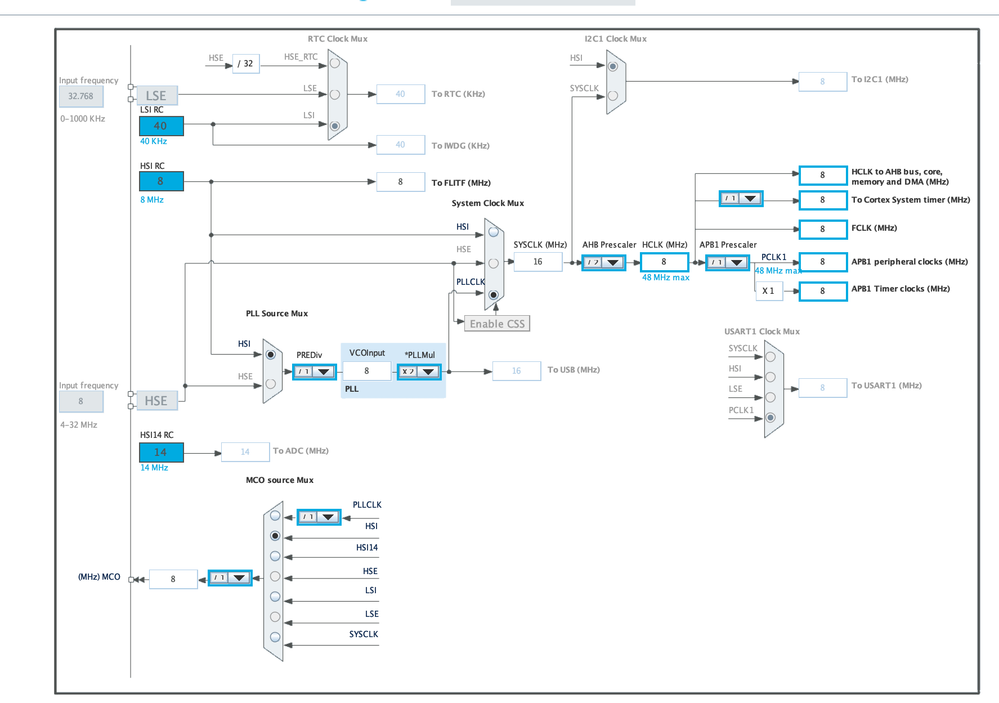

2024-04-27 8:42 AM
see the clock tree I am checking on logic 2 logic analyzer

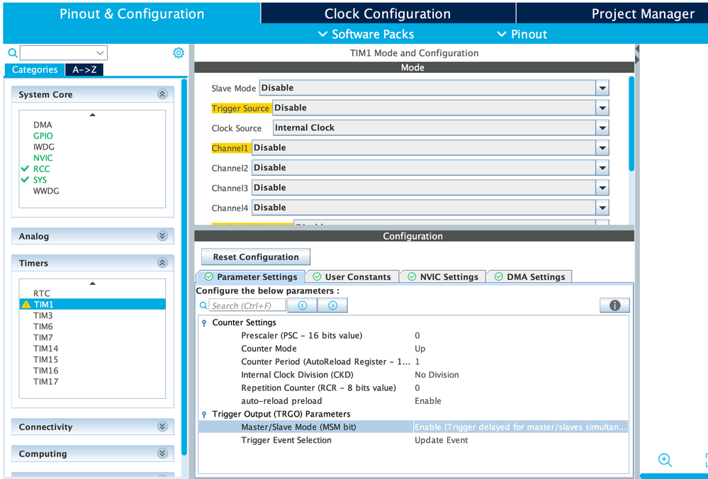

2024-04-27 9:01 AM - edited 2024-04-27 9:27 AM
When I try TIM1 to generate a siganl
Here Timer Clk is 8MHZ no prescalar
ARR is 1
so it will be the half of the signal will be timer output ie,4Mhz but here i am getting 11.08 khz
void HAL_TIM_PeriodElapsedCallback(TIM_HandleTypeDef *htim)
{ if (htim->Instance == TIM1)
HAL_GPIO_TogglePin(GPIOC, GPIO_PIN_8); // this pin is used as output signal
at diffrent ARR value nothing happen 11.08khz is the out .is this cub ide bug ? or what is the problem ?
2024-04-27 9:46 AM
Ok, you want the cpu run at only 8 MHz ? why ?
This is just toggle the pin in software - has nothing to do with any timer !

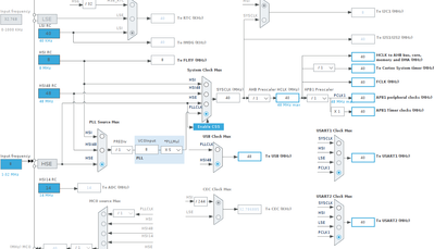

MCO is set to HSI - not pllclk .
so for 40MHz set clock tree:

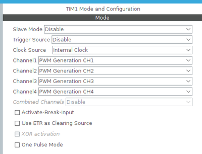

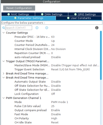

To do some timer output, set any output active : or all ->
here my setting, as example:
