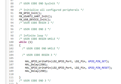

I am using a Nuclro-303RE to develop a USB Virtual Com port, and I am running into an issue that I cannot seem to resolve. Just to verify things, I did put some really simple code in the flash the green indicator on the Nucleo board.

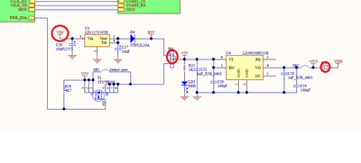

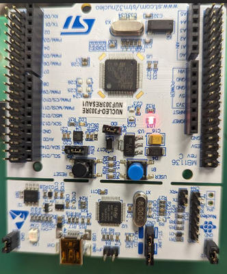

Thanks for the response. Yes, that is correct, it will start up only when the USB is connected to the ST-LINK.

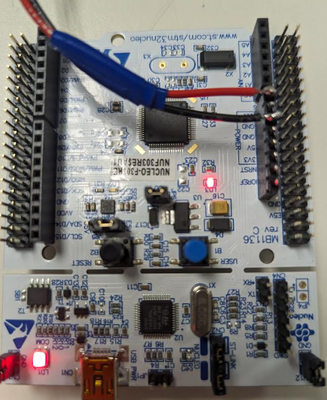

I am using the 5V input, and have the jumpers set accordingly:
The 3.3V regulator started as well.
Other than X2 and the supporting components, the board is unchanged from when it was received.

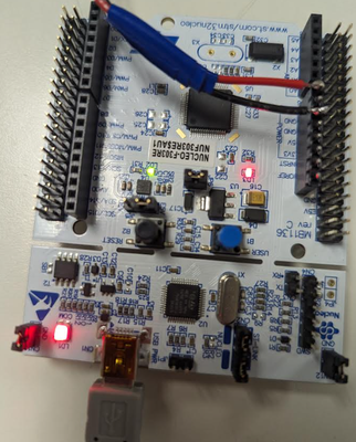

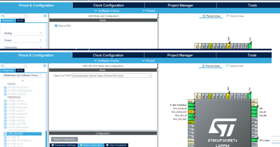

Attached is the project. Just as a sanity check, I connected +5V to vin here with the application generated from the project.
Plugging in the ST-Link it will run.
