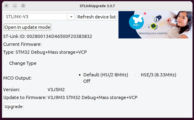

hello.How can i program the STLINK to output 8.33MHz?
program in here?
thx.
Kevin
Peter BENSCH
@KevinNapier For 8.33MHz, you must reprogramme the ST-LINK with the corresponding option during the ST-LINK firmware update.
