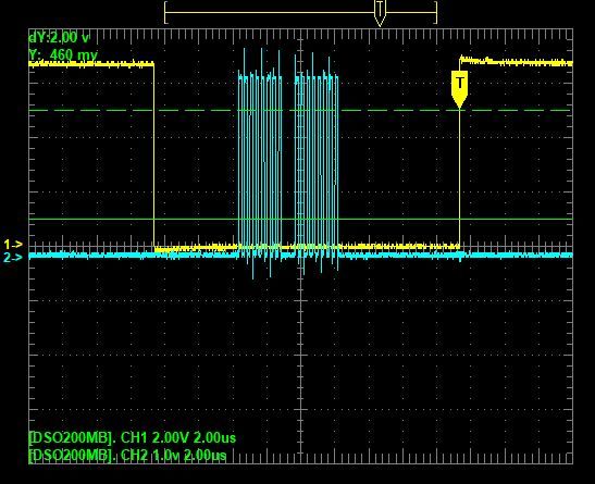

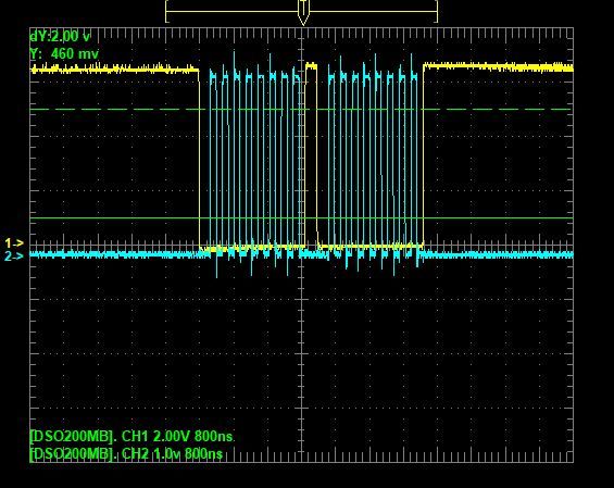

Here is screenshot from my scope using NSS pin controlled by hardware:
Blue curve represents SPI clock, yellow is NSS pin. In my case i'm working with flash chip, to read/write data i need that NSS remains low until both bytes transmitted.
I also tried to use GPIO as output for chip select controlled by software, in this case everything works, but software controlled pin is very slow, even sys.clock is 48Mhz. Here is screenshot:
Is there any suggestions what else to try?

Do you mean that both delays shown in second screenshot (before and after transmission) caused by HAL function?
2020-03-13 7:03 AM
Try yourself - set GPIO pin low by writing into BSRR, then write byte into SPI_DR, wait until SPI_RXNE gets set, read SPI_DR, repeat once more, then set GPIO pin high again.
Observe on oscilloscope the result.

I tried to use own SPI send/receive function and CS pin controlled by software. Result surprised me, sending 2 bytes took only 6us. Using HAL_SPI function it took 24us.
Thanks a lot, my problem solved.
2020-03-14 5:16 AM
No surprises here, just look how overcomplicated the HAL functions are compared to your straightforward one.
HAL tries to account for lots of possible uses of a peripheral in one function, your code does exactly what is necessary.
