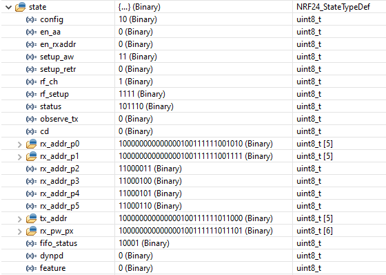

I checked that the device is configured properly before transmitting and to me it it seems to be correct:
One thing I don't quite understand is why the TX_DS bit in the STATUS register is always 1. I have turned off Auto ACK, CRC, Auto Retransmit, and Dynamic Payload Length to keep it simple.

I have tried to debug the code by looking at the STATUS and FIFO_STATUS registers before and after loading the TX FIFO and transmitting. The STATUS register is always 0b00101110 and FIFO_STATUS is sometimes not empty after transmitting and never full after writing the payload. I'm thinking that the issue is with my STM32 code or maybe it is somehow incompatible with the Arduino implementation. Receiver code:

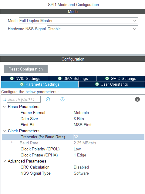

I have also tried different delays at many points, some of which slow down the transmission even more obviously and some make the data garbage. Different SPI clockspeeds have also been tried, this is my SPI config:
2024-05-29 17_32_42-plane_controller - Device Configuration Tool - STM32CubeIDE.png
