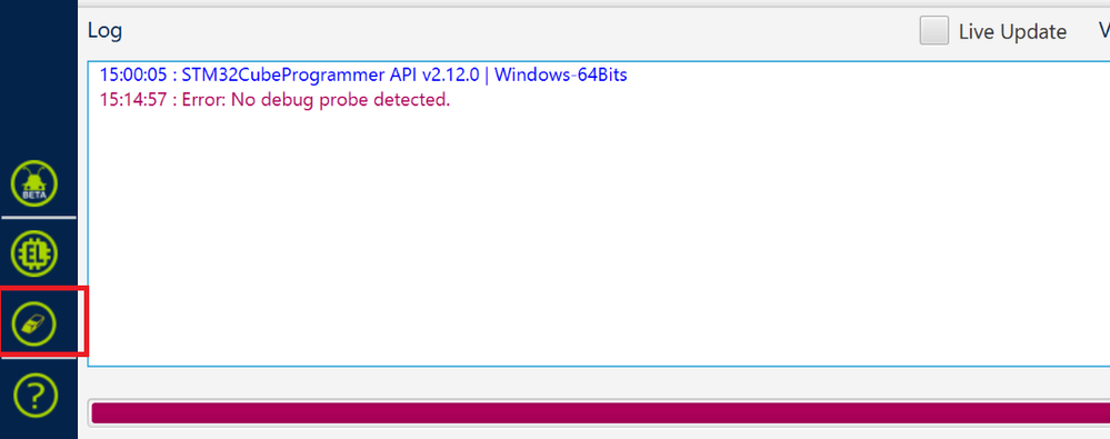

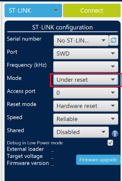

First you have to be able to load new firmware into the MCU. Can you connect under reset?
I suggest:
1- Downloading and installing STM32CubeProgrammer available under this link.
2- Trying to connect under reset
2022-12-02 6:27 AM
If you are able to connect, that means that the MCU isn't damaged and that your application is somehow preventing the debug access (by using PA13 or PA14 as GPIOs for example). You can then perform a full chip erase: and download a led blink application. An example is located under:
STM32Cube/Repository/STM32Cube_FW_G0/Projects/NUCLEO-G031K8/Examples/GPIO/GPIO_IOToggle
If you can't connect, most probably the chip is damaged.
