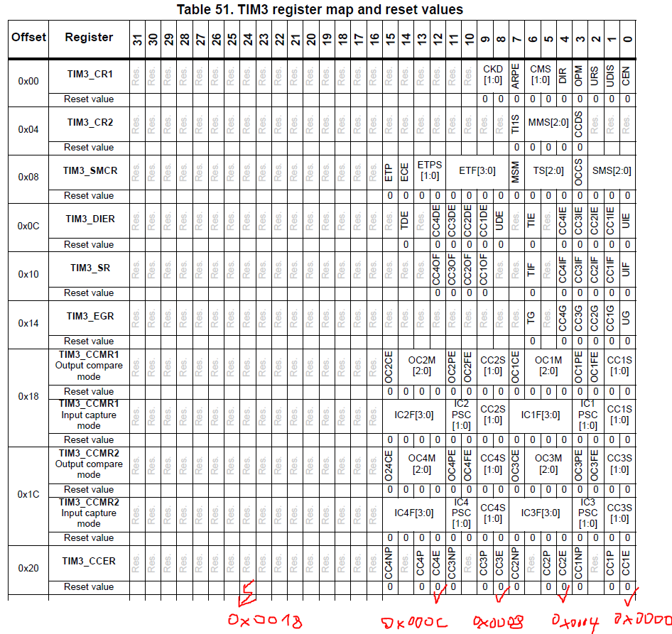

2018-08-29 7:45 AM
TIM_CHANNEL_ALL can't really work with the HAL.
Reason:
If you take TIM_CHANNEL_ALL, this is nothing other than
TIM_CHANNEL_ALL = TIM_CHANNEL_1 | TIM_CHANNEL_2 | TIM_CHANNEL_3 | TIM_CHANNEL_4
what results in
0x0018 = 0x0000 | 0x0004 | 0x008 | 0x000C
The function HAL_TIM_PWM_Start() calls TIM_CCxChannelCmd() and there the fatal error begins in the HAL ...
void TIM_CCxChannelCmd(TIM_TypeDef* TIMx, uint32_t Channel, uint32_t ChannelState)
tmp = TIM_CCER_CC1E << Channel;
If you apply either 0x0000 or 0x0004 or ox0008 or 0x000C the correct bit in CCER - Registers is set.
If you apply 0x0018 what is 24 in decimal, you try to set the 24th bit in the upper region of the 32 bit register which is not used (better reserved). CCER is only using the lower 16 bits ...
