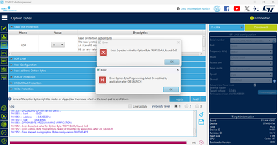

2024-09-08 9:48 PM
This is the error message I get when change to 0xAA for RDP
10:15:52 : UPLOADING OPTION BYTES DATA ...
10:15:52 : Bank : 0x00
10:15:52 : Address : 0x5200201c
10:15:52 : Size : 308 Bytes
10:15:52 : OPTION BYTE PROGRAMMING VERIFICATION:
10:15:52 : Error: Expected value for Option Byte "RDP": 0xAA, found: 0x0
10:15:52 : Error: Option Byte Programming failed Or modified by application after OB_LAUNCH
10:15:52 : Time elapsed during option Bytes configuration: 00:00:00.415
