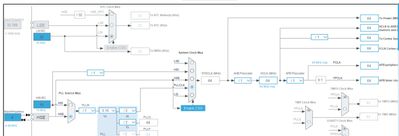

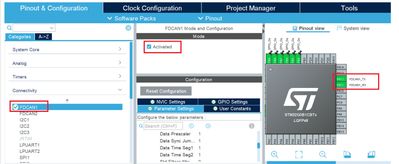

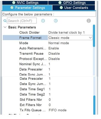

I am using STM32G0B1CBT3 controller and would like to send and receive data in classic mode. I have configured all necessary parameters using cubemx but the buffer is getting full when I call this function HAL_FDCAN_AddMessageToTxFifoQ(&hfdcan1, &TxHeader, TxData).
The CAN termination is connected properly.
Following are my configuration settings:

As per your main.c, you are using Normal mode:
hfdcan1.Init.Mode = FDCAN_MODE_NORMAL;
1- What board are you using? custom or ST board example: NUCLEO-G0B1?
2- Are you using a CAN transceiver?
3- Did you connect another CAN node on the bus?

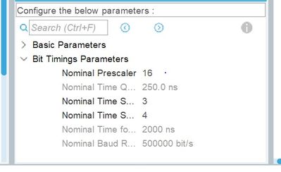

4- This CAN timing is not optimized for good operation:
hfdcan1.Init.NominalPrescaler = 16;
hfdcan1.Init.NominalTimeSeg1 = 3;
hfdcan1.Init.NominalTimeSeg2 = 4;
Your sample point needs to be between 75% and 85%. So please decrease the prescaler as much as possible and increase BS1 and BS2 in such way: BS1 ~= (75% to 85%)x(BS1+BS2).
Please also review this article.

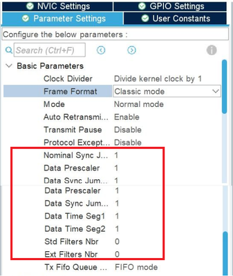

As I am using normal mode and classic frame format is it necessary to configure following parameters for normal mode as well?
2024-10-11 12:44 AM
As you are using Classic mode, no need to configure data timings, but you need to configure the number of filters.
Could you please attach your project?
