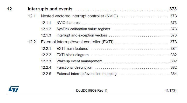

2020-02-03 7:08 AM
Usually one section in "Interrupts and Events".
Here an example from the F40x reference manual:
