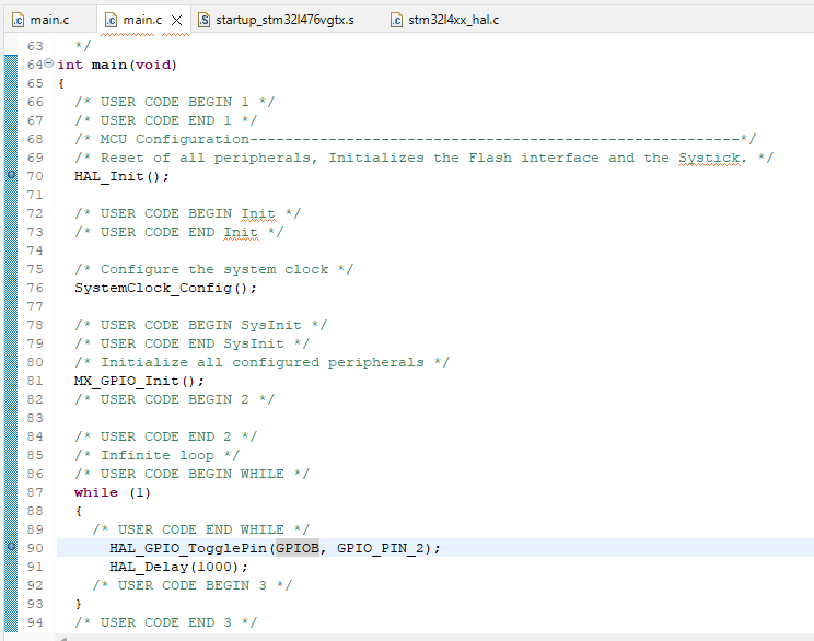

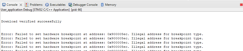

Hello, I wrote two separate codes for this, 1st one is bootloader and 2nd is my application code. Bootloader will jump to the application code which is placed in QSPI memory. Code is executing and running fine, But the issue is I am not able to debug my application code. It is something that my debugger is not able to halt code in the main of my application code. it is showing following error....
Can someone please tell me, how to give access of QSPI memory to set breakpoint or to halt code in main of application code. I am using STM32L476 disc board and STM32cubeIDE.

But when I tried to debug using OPENOCD, it is showing "Error: Cortex-M Flash Patch Breakpoint rev 1 cannot handle HW breakpoint above address 0x1FFFFFFE"
Can we extend the range of FPB? Coz QSPI memory starts from 0x90000000...

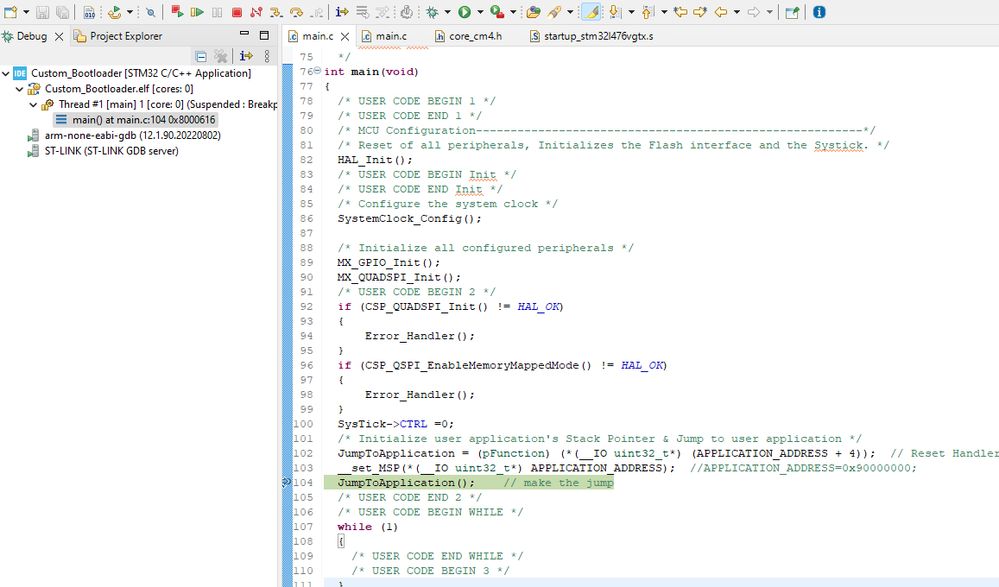

1. Custom_bootloader in which I initialize and set the QSPI in memory mapped mode and then jump to the User_Application.
2.User_Application in which I am toggling LED.

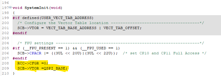

and made changes in linker file and set vector table to QSPI Memory address

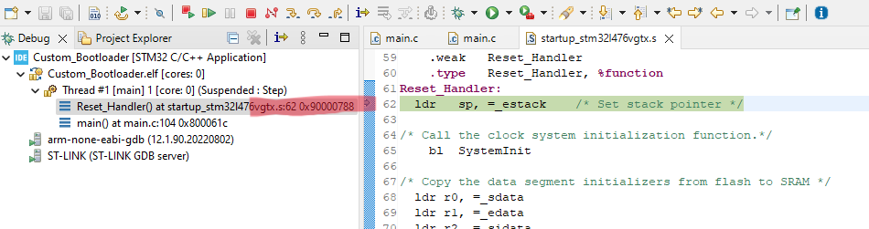

When I tried to debug, it is jumping to the Reset_Handler of the User_Application code and after that it should halt in the main() of application, but it is not halting in main(), Application code is running i.e., LED is toggling but code is not halting.
And I tried to debut it using OpenOCD, I got following warning and errors after jumping to the user application
and I got "Error:Cortex-M Flash Patch Breakpoint rev.1 cannot handle HW breakpoint above address 0x1FFFFFFE"

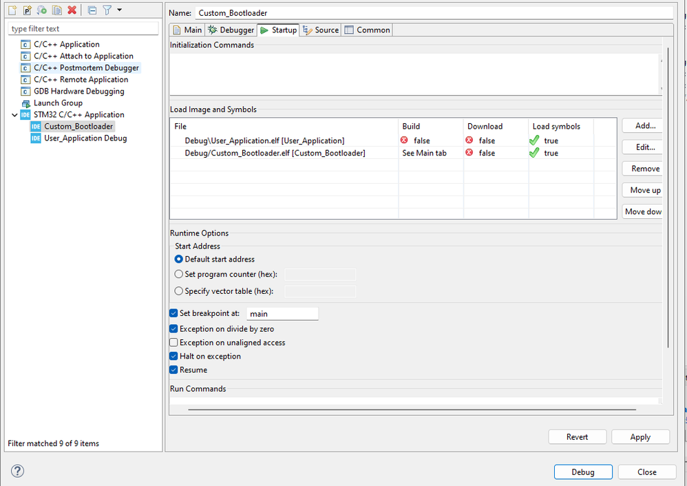

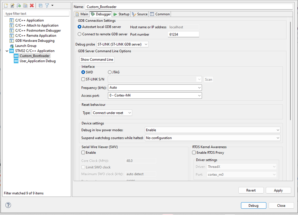

Debug configurations:
I flash user application in qspi memory using external loader.

Did you solve your problem ?
I have exactly the same issue.
I can debug the apllication from QSPI normally using STM32CubeIDE 1.12.1, but not using any more recent version after that. But if you copy the GDB Server from 1.12.1 overwriting the one from 1.13.x or 1.14.x, breakpoints works again in NOR.
I suspect GDB Server in recent versions defaults to "soft brekpoints" in QSPI region, instead of "hardware breakpoints", and obviously fails to insert them.
Cfr. see https://www.openstm32.org/forumthread8403
I'm still on 1.12.1 for this issue!
