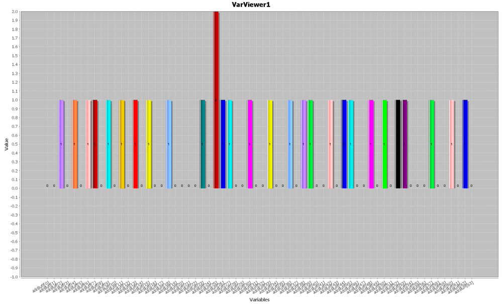

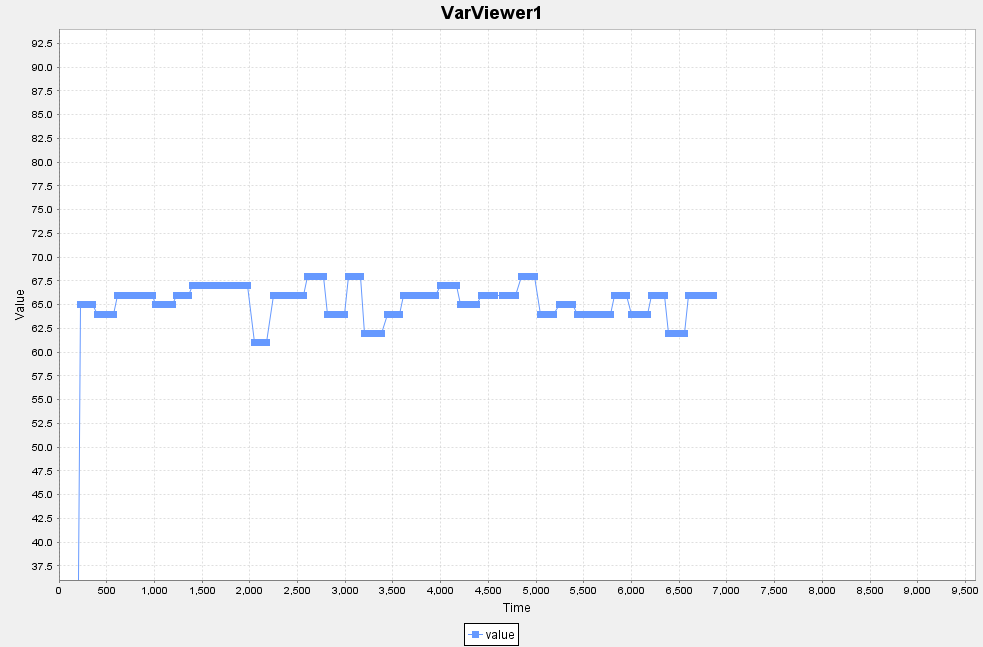

I have a problem with the adc converter of the microcontroller stm32L053. I am in the prototype state and am using the Discovery Board.
I only have the analog AN0 pin connected to ground. When I execute the reading the converter does not return 0 and I have ./- 5LSB of noise. Is there something I'm wrong about?

2019-05-08 9:44 AM
Do not look at the translated values. Look at the digits. If the steps in tour diagramm translate to digit and are not by some calculation clipping that is +/- 4 LSB max. That does not sound to bad.

2019-05-09 1:39 AM
I try the calibration and the offset return to 0. The noise is alwais +/-5 digit.
I try to implement a mean to 8 sample, but i don't like this solution.
