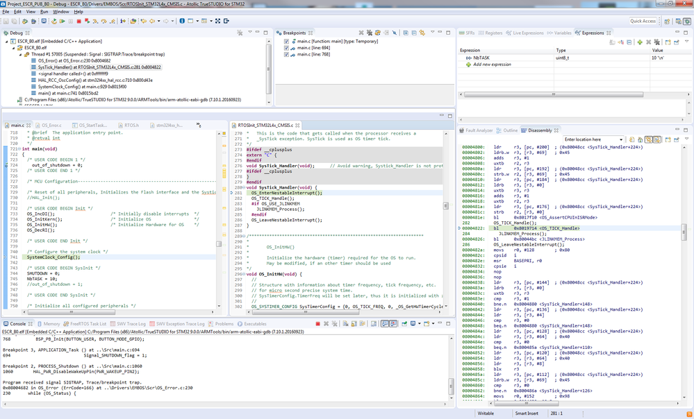

2019-09-03 1:17 AM
Hi Ozone(O3), thanks for your reply.
I checked the BOOT0 and it's pulled down (Res10k).
Here the screenshot after a battery deconnection. The wake up should work properly but it is stuck in SysTick_Handler!
Tel me if you can see the picture!!!
Any ideas ?
Thx
2019-09-03 2:00 AM
You should have told that an OS (presumably FreeRTOS) is involved.
First, the terminology is not clear.
If you disconnect both VDD and Vbat, the MCU is basically power supply. Reconnecting it constitutes a POR, not a wakup.
No system states (variables, values) are defined then, and need initialisation (done in the startup code before calling _main).
Caps on the board might keep some RAM cells and register values alive for a short period, but better not rely on it.
If the system hangs in the systick handler, you could possible check what goes wrong. Better switch to assembly mode, and check addresses and register contents.
Since (as I understand it) the code works after a hard reset (NRST), I assume skipped parts of the initialization (or reliance on unitialized values) is the culprit.
