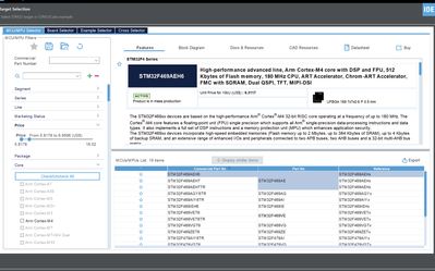

2024-10-14 4:17 PM - edited 2024-10-14 4:20 PM
Thank you@mƎALLEm and @Tesla DeLorean
I have been designing PCBs for 27 years and all manufacturers do give the 1K or 10K price (and always did). And your colleague @STTwo-32 also said so above.
If they didn't, how could companies make decision on which micro (or any other IC) to choose?
ST does show the 10K price on CubeIDE (see screenshot below) and you can even use that filter is filter by price on there, but once you select the range you cannot sort the results so you have to go through each one. that is why I was asking @STTwo-32 how he did it and if he could send the link because perhaps I have been looking at the wrong selector tool.
So hopefully he can send me the link.

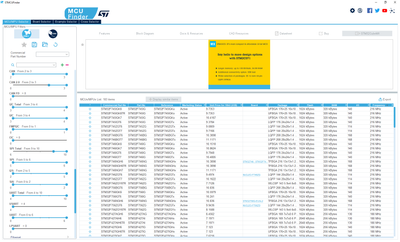

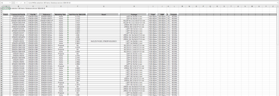

2024-10-15 2:38 AM
Hello @Ricko
As I said before you can use the ST-MCU-FINDER-PC to select products according to specific filters (APIs, Memories, Packages ...). you can also select a filter of price. the final results will show the package, Flash, RAM, ... including the Unit Price for 10 KU:
You can also click on the export Button to extract this data on a excel sheet:
