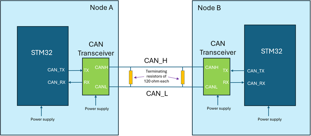

As you are using normal mode, did you establish a complete CAN bus like this?:
2025-04-24 11:46 AM - edited 2025-04-24 11:54 AM
I've never received a CAN message from this setup. Not in debug mode or when running the standalone application. I check this using either a logic analyser or a different CAN node that can receive CAN messages. And yes, the picture you provided was my exact setup.
