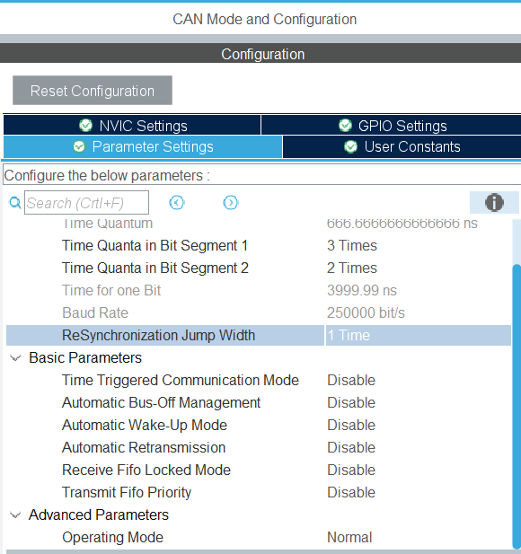

First I know my baudrate of the ACU(Actuator Control Unit) want is 250 kb/s.
So I tune it that.

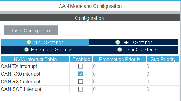

The NVIC is needed for CAN RX0 interrupt.

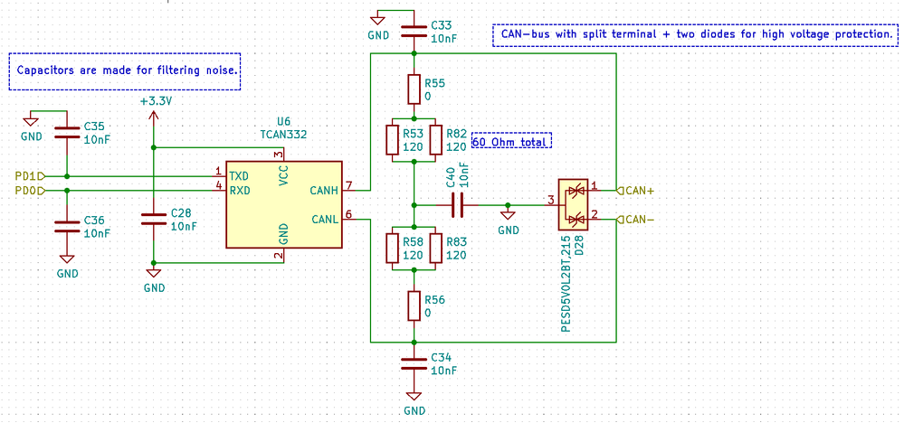

}Here I have my CAN-bus transmitter schematic. I did just follow the recommended settings. Yes, I have 60 ohms termination enabled on both sides. The reason why I'm using double 120 and not 60 ohm resistors is because it was cheaper to do that because I'm using 120 Ohm resistors for LED diodes as well.
The datasheet of the diode is: MMBZ6V8ALFHT116: Transient Voltage Suppressor (mouser.com)
