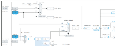

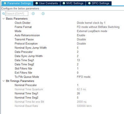

I didn't remember that I modified something on the configuration. The are some screenshots of CubeMx:
At this stage I prefer that you share your schematics mainly the CAN part.

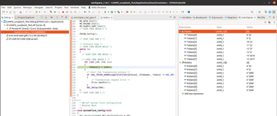

We can see that Tx buffer is getting filled up on executing the code and once Tx buffer is fully filled with 8 bytes, Rx buffer starts to get filled, but only 2 bytes.
Can you let us know if this is the expected behaviour? Why Rx buffer is not fully filled?
Is Rx interrupt firing? ---> How can we check this? Is there any register for this?
Simply because the Tx DLC = 2:
TxHeader.DataLength = FDCAN_DLC_BYTES_2;
Need to modify it to be:
TxHeader.DataLength = FDCAN_DLC_BYTES_8;

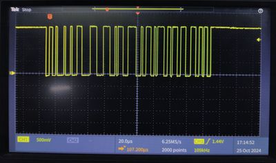

But still we could not observe activity on Tx pin in Debugger mode.
Then we disabled the debugger mode and simply booted our system. At this point, we were able to see continuous activity on Tx pin as below
Cannot understand why it did not work when MCU was in debugger mode.
