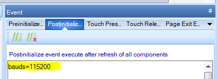

I set baud 115200 in nextion and st mcu. it is ok.
I try this code but issue is continious. I cant send any data display but i can send data to pc via uart .
What is my fault?
