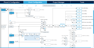

Hi , Please find below the clock configuration , I have used TIM2_CH1 for generating PWM signal @ PA0 pin. All timers are configured to 32 MHz only, In my clock configuration , the MCO source is not selectable ( greyed out). And the below code is what I used for the same. Please guide me how to get the desired frequency of PWM signal( atleast 16 MHz) . FYI, I am using STM32 L073RZ board.
The value of htim2.Init.Period was changed many times and at max I have got only 580 Khz signal by setting this value as "55-1".

2024-02-27 9:44 PM
Search tutorials to use MCO ... for example:
https://community.st.com/t5/missing-articles/how-can-i-output-a-clock-signal-to-the-stm32-s-mco-pin/td-p/49583
If your timer "period" is set to 55, then its frequency will be 32MHz/55=582kHz... what is wrong with that ? :)

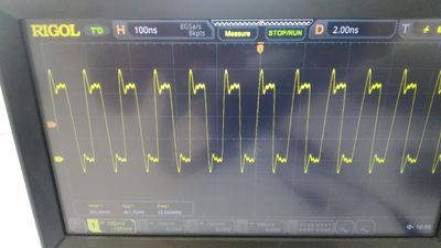

Thanks for pointing out , using RCC and MCO and I could generate 12 MHz clock signal ( square pulse) , but it is ringing like below , kindly guide me where I am doing wrong ( or) the exact output from the MCO will be like this.
Below is the system clock configuration.
* The system Clock is configured as follows :
* System Clock source = PLL (HSI)
* SYSCLK(Hz) = 12000000
* HCLK(Hz) = 12000000
* AHB Prescaler = 1
* APB1 Prescaler = 4
* APB2 Prescaler = 2
* HSI Frequency(Hz) = 16000000
* PLL_MUL = 6
* PLL_DIV = 2
* Flash Latency(WS) = 1
* @retval None
2024-02-28 4:05 AM
Wrong probing, probably like in figure 1.9 there:
https://download.tek.com/document/02_ABCs-of-Probes-Primer.pdf
