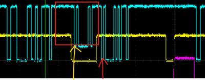

2025-03-14 10:49 AM
The red arrow is where the MCU should wake up on the start bit from stop mode. The red block is where the Rx should ignore the received data, but the yellow arrow is the data received, which is not expected.

2025-03-14 11:46 AM
You don't control the UART_RX pin. It's an input.
Looks like two things are trying to control it at once, which is why the low level is not at 0 but at about 1/3 of the full range. There's a fundamental hardware/design issue here.
It's data on the line. Why are you saying it's unexpected? Ignore it after you receive it if you're not interested in the byte. Or change the behavior of whatever device is sending the data if you can.
