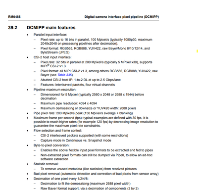

Do you mean does the STM32N6 support a 16M camera?
As mentioned in the reference manual that the max pipeline resolution is 4094x4094.
So, the input capture buffer is 4094x4094 16bits pixels = 16.76Mpixels.
The image signal processor ISR can support 16M camera.
I hope this answer your request?

I did read that, but the resolution for the IMX519 is 4656x3496. Also I need to produce a 16MP output file.
