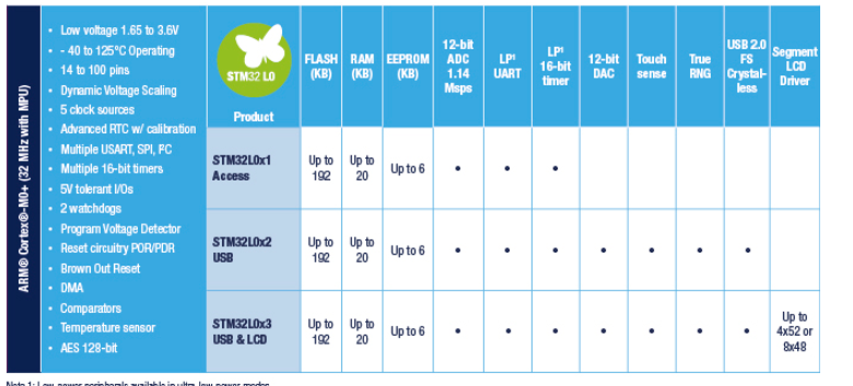

Dear
ketan
,we don't have L072 development board, but we do have L073-Nucleo board which is the same device as L072 with more features. You can use it in development phase.
For documentation, you can get all the info on st.com website.
http://www.st.com/en/microcontrollers/stm32l072rb.html
Best regards,
Tilen
2017-10-06 3:59 AM
Hi
ketan
''I need the technical difference of
STM32L072RB andSTM32F072RB''
I recommend you to have a look to
Application note aboutMigrating between STM32F0 and STM32L0 microcontrollers.There is no dedicatedboard for the
STM32L072RB device but you can useSTM32L073RZ-Nucleo orSTM32L073Z_EVAL as the major difference between the two linesis theLCD driver support forSTM32L0x3 line.
-Nesrine-
