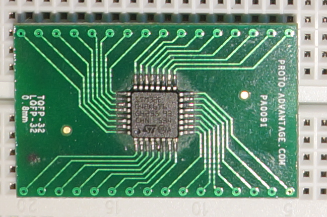

I have a STM32F042K6T6, It works fine, no problems, when I am using it on a breakout board:
Reset pin voltage goes to VDD level, Debugger works, I have a firmware project with Display, External ADC, etc, everything works.
It is LQFP 32. I need more I/O's, so I decided to switch to a 48 pin device.

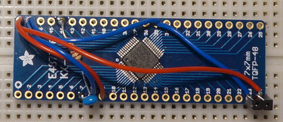

So this is a breakout board I prepared for that:
Problem is: I can't get it up and running.
I tried several times with different types of 64 pin STM32 devices.
The Reset pin voltage stays at VSS level.
I connected it as follows:
pin 7: 100 nF cap to GND (reset pin)
pin 8, 23, 35 and 47: GND
pin 9, 24, 48: VDD = 3V3
pin 44: 10 K resistor to GND (BOOT0 pin)
I also added a 10 uF cap between pin 23 and 24, and two 100nF caps between pins 8/9 and 47/48 (soldered on the bottom side)

'It does not work' is a very generic and not very helpfull statement. One possible cause could be your missunderstanding about decoupling capacitors. Decoupling capacitors do not need to be places somewehere, but places close to the device. Take your finger, start at the center og the chip, then follow VCC out to your capacitor and back over to VCC back to the chip. If the loop is 'to large', problems may arise as decpupling will not work sufficent. Another problem is with missing ground 'plane ' on your board. They only connect off board. That may also cause problem.

I'd connect also pins 36 and 1.

Must connect VDDA/VSSA, the PLL and POR are on the analogue side.
2017-11-27 11:54 AM
Pin 32 is VDDIO2, needed for the SWD pins.

Right. I already have that, pin 8 and 9, seen on the image, the red and blue wire.
2017-11-27 2:01 PM
pin 36 is VDD USB on that device. It wasn't connected because I don't use USB. I tried your suggestion, connected pin 1 and 36 to VDD, but it still doesn't work
