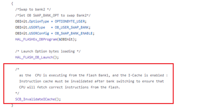

To my opinion, you need to invalidate the ICache before jumping so the CPU will fetch correct instructions from the flash using SCB_InvalidateICache().
See for example FLASH_SwapBank: https://github.com/STMicroelectronics/STM32CubeH7/tree/master/Projects/STM32H743I-EVAL/Examples/FLASH/FLASH_SwapBank
The example invalidates the I cache before executing from the new Bank.
