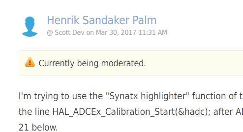

I'm trying to use the ''Synatx highlighter'' function of the forum instead. If you're using HAL, simply do as I do; add the lineHAL_ADCEx_Calibration_Start(&hadc); after ADC initialization, before you start the ADC. See line number 21 below.

Edit:
To whoever is reviewing my post: Why is this happening to me, all of a sudden? That my posts needs reviewing.
2017-03-30 6:09 AM
The person who reviewed my post obviously didn't read it, since I don't see a reply to my question.
2017-03-30 7:14 AM
That isn't the purpose of a moderation review, which is to check for spam, or offensive or illegal content.
Most links and formatted code now get reviewed due to recent spam levels.
