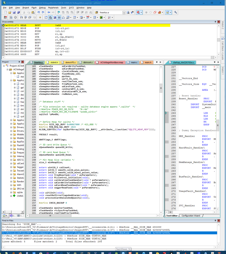

When I start my program from the uVision debugger the code runs to a debug instruction in the start-up code.
It requires three run push buttons to get it past the debug instruction. The program then works perfectly.
This problem only happens when I include a large AXI ram buffer for sqLite which I use for storing real-time data.
The variable is defined thus
/* Define Heap for sqlite */
#define SIZE_SQL_BUFF 0x00067000 /* 421,888 */
#define MIN_REQ_SQL_BUFF 1024
ALIGN_32BYTES(char sqlBuffArray[SIZE_SQL_BUFF] __attribute__((section("SQLITE_HEAP_MEM"))));The scatter file is:

2020-01-11 4:41 AM
This BKPT is because there is a printf or puts in the code somewhere. If you have a debugger UART, or want to use the SWV channel you will need some fputc() code.
Also you should enable SRAM clocks.

2020-01-12 5:57 PM
Hi Clive
Yehh! I figured it out.
I start the RAM Clocks in the Main program.
To fix it i did what this link advised:
https://mklimenko.github.io/english/2018/11/02/disable-semihosting/
It' was the semihosting capability built into the compiler. (I am not using microlib can't remember why)
You turn semi hosting off with some macros:
