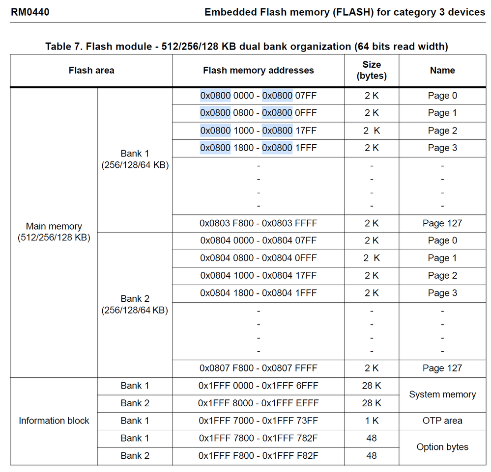

I have STM32G473VCT6 MCU. According to part number this device should have 256kB flash (Size code C). Flash size register (0x1FFF75E0) also shows 256kB (reg. value 0x100). However I can read and successfully write 512kB of data. STM32CubeProgrammer also shows 256 pages with 2kB each. Memory layout works as for 512kB device.

If I am working in dual bank mode, should I use half of each bank (64 pages instead of 127)? Or should I use only 1 bank? Or half of each page? How about addressing? Do I have hole in address space between bank 1 and bank 2? Does addressing changes when I switch to single bank mode?
These questions arise from ambiguity in STM32G4 Reference Manual (RM0440) on memory layout. All the memory layout tables in the document are valid for 512kB device but not always makes sense for 256kB or 128kB devices.

Found it, here you go:
You assumption is correct. Gap in dual bank mode, no gap in single bank mode.

> Question 2. How should I organize my code that it would be compatible with true 256kB device? I think it is not common to have more flash than You paid for.
I agree with your assessment that it's terribly ambiguous here. On other families, there is a gap in dual bank mode which ST confirmed. If I can find the post about this, I will edit and link it.

I assume that for 256kB device in dual bank mode "tested" flash part is half of each bank (page 0-63), then address space is 0x08000000 - 0x0801FFFF for bank 1 and 0x08040000 - 0x0805FFFF for bank 2. In single bank mode, "tested" address space probably would be: 0x08000000 - 0x0803FFFF.
I just want to have confirmation that my assumption is right.
2021-12-20 7:35 AM
