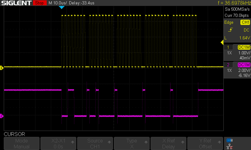

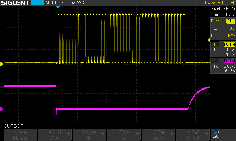

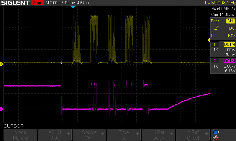

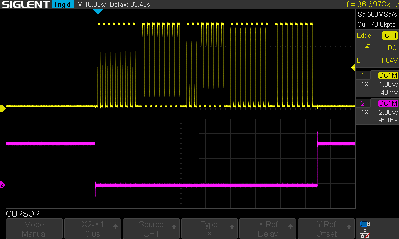

This is some screen of the signals :
CS :MOSI :
MISO :

I have a screen of a workwell MISO (in the same case) if you want to see how it's should looks like :
