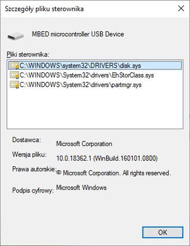

2020-02-28 12:43 PM
How does it look in Device manager and in "Devices and printers"?
How does it look in diskpart (detail disk) ?
-- pa
2020-02-28 1:27 PM
Did you ask about this information?
Description - Disk drive
Manufacturer - (Standard disk drives)
Model - MBED microcontroller USB Device
Bytes / sector - 512
Loaded media - Yes
Media Type - Removable Media
Partitions - 1
SCSI bus - 0
SCSI logical unit - 0
SCSI port - 0
Target SCSI device ID - 0
Sectors / path - 1
Size - 544.00 KB (557 056 bytes)
The total number of cylinders - 1 088
Total number of sectors - 1,088
The total number of tracks - 1 088
Tracks / cylinder - 1
Partition - Disk # 5, partition # 0
Partition size - 544.00 KB (557 056 bytes)
Partition start offset - 0 bytes
