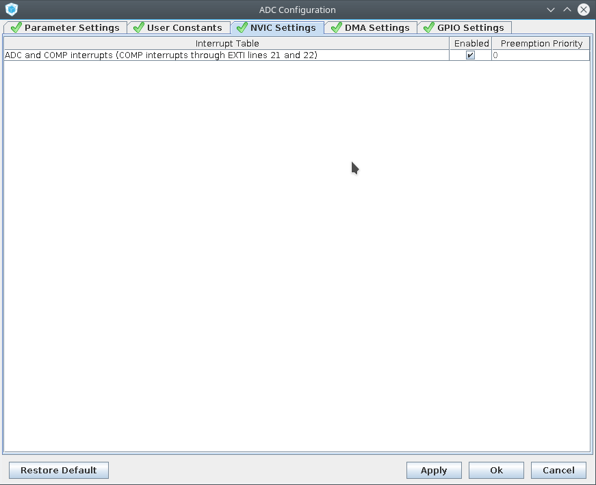

Hi. I have a very strange behaviour with adc.
The CubeMX setup is shown belowThis is my empty callback
void HAL_ADC_ConvCpltCallback(ADC_HandleTypeDef *hadc) {
}And the main
int main(void)
{ HAL_Init();SystemClock_Config();
MX_GPIO_Init();
MX_ADC_Init();HAL_ADC_Start_IT(&hadc);
while (1)
{ HAL_GPIO_WritePin(Led0_GPIO_Port, Led0_Pin, GPIO_PIN_SET); HAL_Delay(100); HAL_GPIO_WritePin(Led0_GPIO_Port, Led0_Pin, GPIO_PIN_RESET); HAL_Delay(100); }}
The program does not work. In order to have my led blinking it working I have to comment out the line
What is wrong?

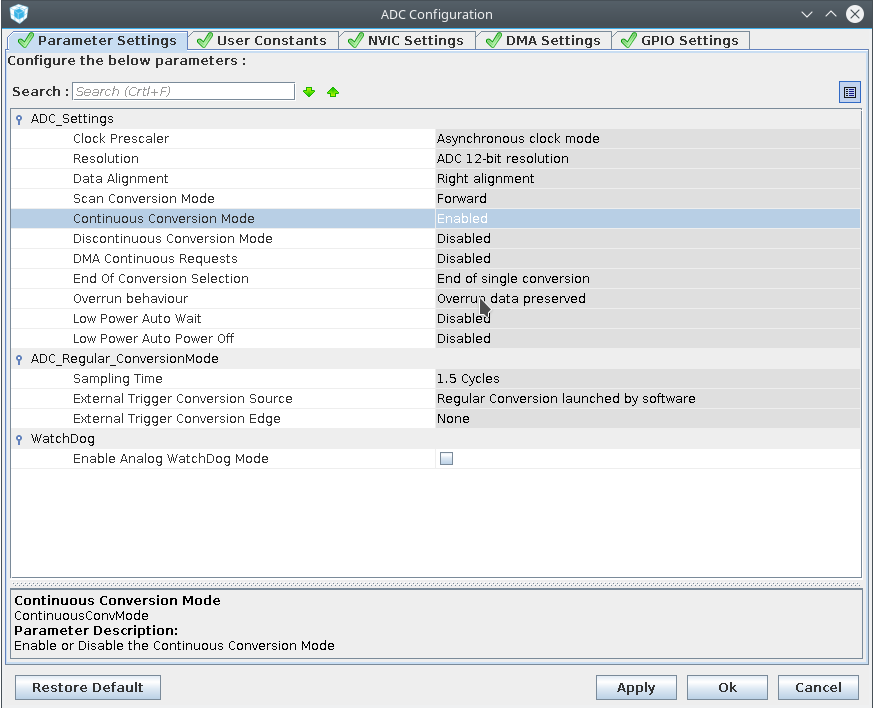

Now I have switched my project to dma but I have a problem.hadc.Init.ContinuousConvMode = ENABLE;seems to be not considered because the variable will updated only one time.2018-01-29 4:03 PM
I have this config:
________________ Attachments : ADC setup.jpg : https://st--c.eu10.content.force.com/sfc/dist/version/download/?oid=00Db0000000YtG6&ids=0680X000006Hy5L&d=%2Fa%2F0X0000000b3o%2Fa7Kl92Re6e_ws6plk1RoQdCkcgVxoKKzc9XNMWKsjSA&asPdf=falseWe’re moving the ST Community to a new platform to give you a better and more reliable community experience.
