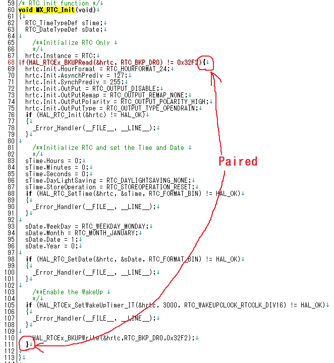

2018-04-25 3:31 AM
Hi, Imen D.
I tried with these.
STM32CubeMX 4.25.0
STM32Cube FW_L4 V1.11.0NUCLEO-L476RG
Generated MX_RTC_Init(void) function in rtc.c is,
The problem John Smith said looks alive.
------John Smith said----------------
As I see, `if(HAL_RTCEx_BKUPRead(&hrtc, RTC_BKP_DR0) != 0x32F2){` line moved up and are called before `HAL_RTC_Init(&hrtc)` function.
Thanks.
