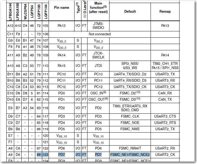

How can I multiplex SRAM,NOR Flash and NAND Flash on PD7 ? It's function as PD7 FSMC_NE1/FSMC_NCE2 on pin 88 for STM32F103VCT6, is it configurable via software or I need to put a latch / multiplex chip for it ? Any examples for it (schematic)? What's the common application for NAND flash ? Can I run my code from NOR Flash ? I saw there's boot option ''System memory is selected as boot space'', page 48 STM32 reference, chapter 2.4 Boot Configuration... Thanks #fsmc2014-04-25 4:57 PM

Does you part have the FSMC? If it does aren't the pins used materially identical?

Get the data sheets and work through the pin lists.
http://www.keil.com/mcbstm32exl/mcbstm32e-base-board-schematics.pdf

I saw on STM32F103VCT6 Pin 88, PD7, FSMC_NE1/FSMC_NCE2We’re moving the ST Community to a new platform to give you a better and more reliable community experience.
