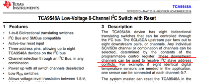

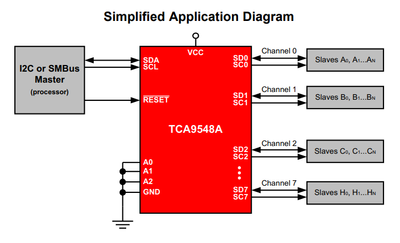

@yasinbjk50 wrote:The multiplexer i mentionoed is TCA9548A.
So this:
https://www.ti.com/product/TCA9548A
Yes, as its datasheet shows, that is designed to allow a single I2C Master to connect to multiple I2C buses:

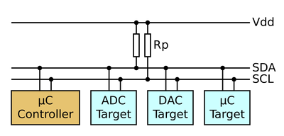

The whole point of a bus is that it can be shared by multiple devices - I2C is a bus.
You can connect multiple devices to an I2C bus - it is the Slave Address which distinguishes them.
Example from Wikipedia:
Perhaps you need to read-up on the I2C bus:
https://en.wikipedia.org/wiki/I%C2%B2C
