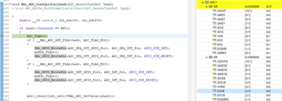

void HAL_ADC_ConvCpltCallback(ADC_HandleTypeDef *hadc)
static __IO uint16_t cnt_adc1=0, cnt_adc2=0;
if (hadc->Instance == ADC1)
ADC_FLAG++;
if ( __HAL_ADC_GET_FLAG(hadc, ADC_FLAG_EOS))
HAL_GPIO_WritePin(ADC_INT_GPIO_Port, ADC_INT_Pin, GPIO_PIN_SET);
myEOS_FLAG++;
HAL_GPIO_WritePin(ADC_INT_GPIO_Port, ADC_INT_Pin, GPIO_PIN_RESET);
if ( __HAL_ADC_GET_FLAG(hadc, ADC_FLAG_EOC))
myEOC_FLAG++;
HAL_GPIO_WritePin(GPIOA, ADC_TEST_Pin, GPIO_PIN_RESET);

adc_result[0]= ADC1->IER;
HAL_ADC_Start_IT(&hadc1);
adc_result[1]= ADC1->IER;
adc_result[2]= ADC2->IER;
When I let run my code, this timer interrupt is triggered and I read the registers for ADC1 and ADC2. ADC2 is started before because of the different triggers. At this point, the EOSIE in set for both ADC.
When the interrupt triggers my ADC1_Interrupt callback-function, the EOSIE and EOCIE is zero, but the EOS and EOC-Flags are set to one, visible in my CubeIDE Debug environment.
For ADC2, the EOSIE-Flag is one over the whole time. But the resulte is still the same, I have just one data event during the ADC-Cycle.
I see also, the callback-function is never reached, rather from ADC1 nor from ADC2.
HAL_ADCEx_EndOfSamplingCallback(ADC_HandleTypeDef *hadc)
But as mentioned above, the EOS flag is raised.
