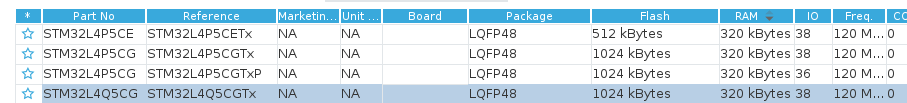

2020-03-11 4:58 PM
320K of RAM is now available (evaluation) in a LQFP48 package in the STM32L+ range - excellent.
2020-03-11 6:21 PM
And UFQFPN48
https://www.st.com/en/microcontrollers-microprocessors/stm32l4p5ce.html
