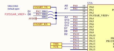

On nucleo64 the onboard st-link uart is here ->
2025-06-02 1:25 AM
My PA2/PA3 are already set to USART_TX/USART_RX respectively.
