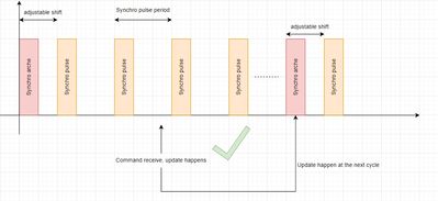

My aim is to make two PWM signals like this :
The red signal is named "synchro arch" and the orange one "synchro pulse". Both have their own duty cycle, the period of synchro arch is 100 times the synchro pulse period and there is a shift (delay) between the two signals.

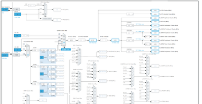

My MCU use two 32 bits timers (TIM2 and TIM23) and the USART3 to work. For the clock, I used the external clock of the ST-Link (HSE 8.33MHz).

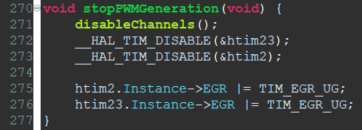

In this part I describe the philosophy of the attached code of the timer module. First, there are two functions startPWMGeneration and stopPWMGeneration. In the main module, when I receive commands, I stop the PWM generation, execute a setter function (like setSyncPulsePeriod) and restart the PWM generation with startPWMGeneration. In setter functions, I write into timers registers like ARR, CCR1 and CCR2.

I stop the timers with stopPWMGeneration like this:

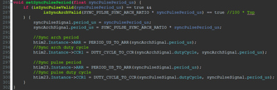

Then, I execute the setSynchroPulsePeriod function :
This function set the synchro pulse period AND the synchro arch period (by multiplying by 100).
When I set the ARR registers and recalculate duty cycle (CCR1), I restart timers with startPWMGeneration :

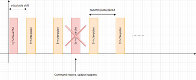

Good point! I need to change all the values ... but I need that the previous cycle end and that the next cycle begin after. Indeed, I don't want that a synchro arch happen during the current cycle :
This case must never happen :
But this case is acceptable

Here is my macro to calculate period, with TIMER_FREQUENCY_MHz = 8.33 :
So according to this macro the ARR register must be :
TIM2 synchro arch ARR (501) = (uint32_t)8.33 * 501 * 100 - 1 = (uint32_t)417332 (0x65E34 in registers live debug)
TIM2 synchro arch ARR (500.9603842) = (uint32_t)8.33 * 500.9603842 * 100 - 1 = (uint32_t)417299 (0x65E13 in registers live debug)
TIM23 synchro pulse ARR (501) = (uint32_t)8.33 * 501 - 1 = (uint32_t)4172.33 = 4172 (0x104Cin registers live debug)
TIM23 synchro pulse ARR (500.9603842) = (uint32_t)8.33 * 500.9603842 - 1 = (uint32_t)4172 = 4172 (0x104C in registers live debug)
So ... I don't understand this behavior, because the ratio synchro arche / synchro pulse stay 100 in the two case ...

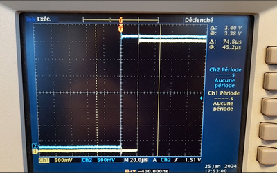

To illustrate my new issue, I take two photos:
The first one is when I sent 501µs to UART >
There is a jitter

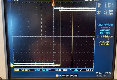

The second one is when I sent 500.0804322µs to UART >
There is no jitter

It's a little hard to know how to interpret this. Your scope shows two edges, but your illustrations above show a series of pulses. I would have expected to see 2 pulses on the scope, not just 2 edges.
