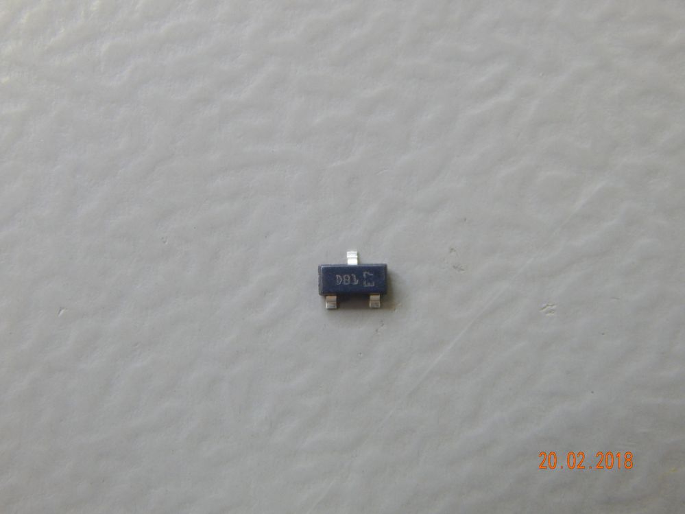

if You open AN926 Application note (pls see attached),
You will see a marking format for SOT package:
ZZZ W
Should not the year be marked? is not there a mistake in document?
I have a parts (pls see photo) from Arrow and their engineers can not answer this question.
Best regards and thank You
Paolo Filipov.

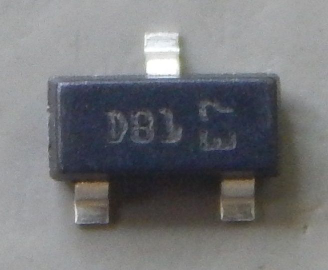

I cant read the marking, what does it read ? D01 E7 ?
E7 looks like 2015- week 7 manufacture date.

Would have taken a minute to crop and size the photo.
D81 E7
Would suggest E (Week 9-10) 2017 or 2007, assume the former

I think the same:
it can be
2015- week 7 and
it can be
But there should bea document where we can find the date codes. I think it's common information and most of
manufacturers publish it.
And there isthe document (attached in my 1st message), yes it's old (2008) but I can not find another one. Therefore I ask ST engineers to help me.

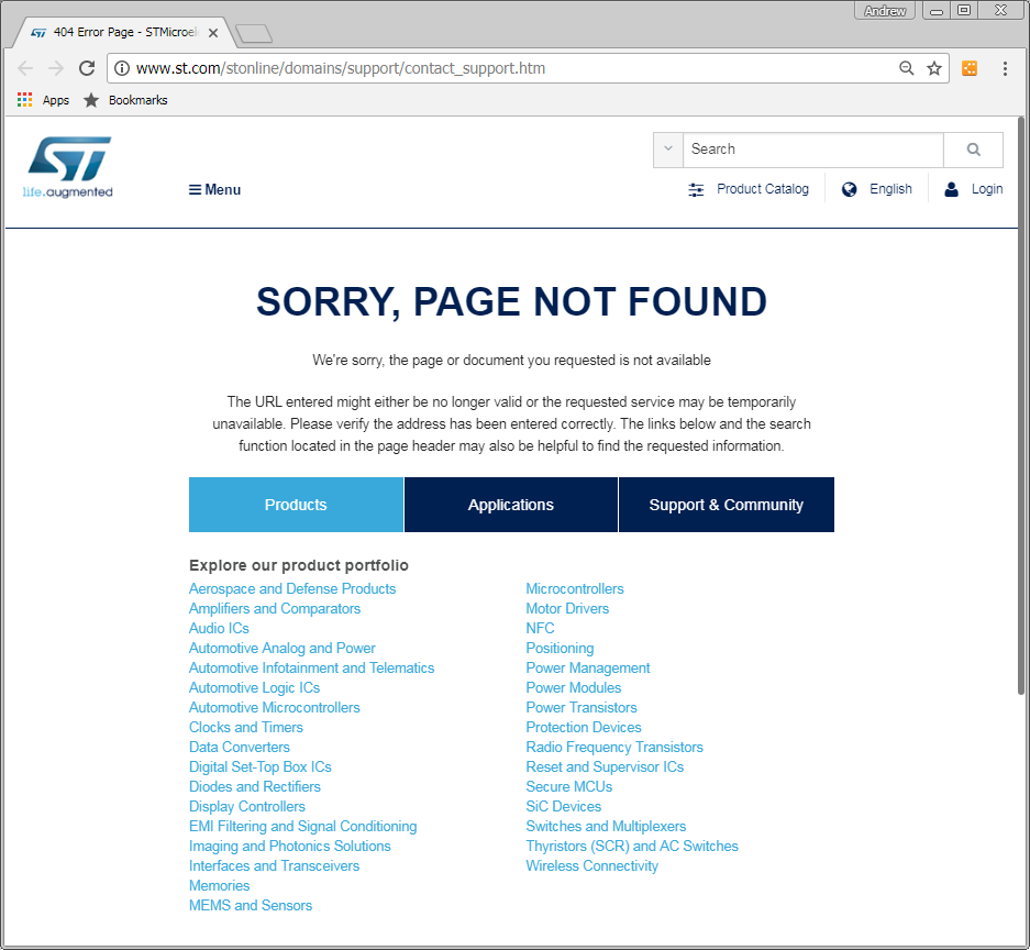

T J wrote:
however, at the bottom of that document...
Contact information
If you have any questions concerning matters raised in this document, please contact STMicroelectronics at the following address:/external-link.jspa?url=http%3A%2F%2Fwww.st.com%2Fstonline%2Fdomains%2Fsupport%2Fcontact_support.htm
Hmmm ... not useful:
Perhaps
Kling.Brian
's ''internal resource'' could also address that one ... ?
