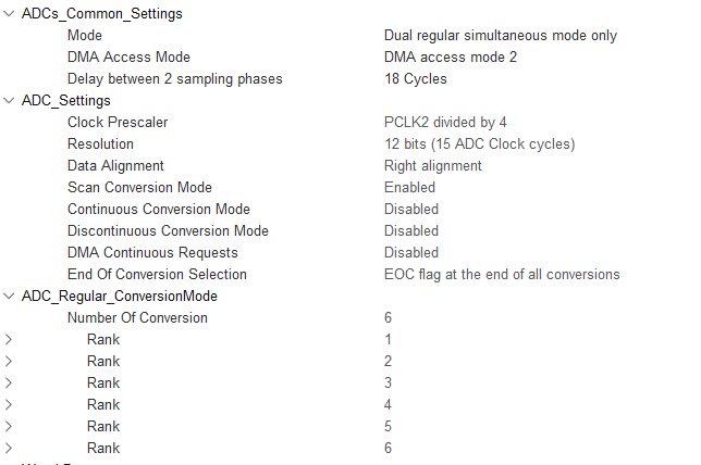

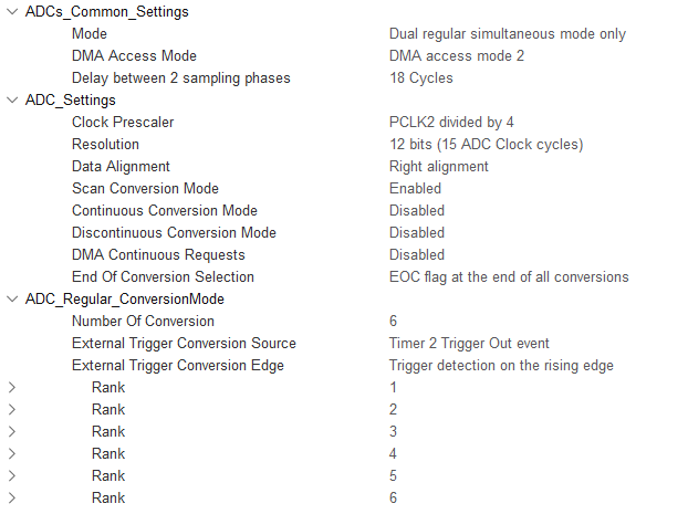

I am using a STM32F767BITx LQFP208. I have to measure 12 channels. 6 channels measure the voltage and 6 other channels measure the intensity. Samples from voltage and insitensities shall be done as simultaneously as possible.
I am using ADC1(voltage) and ADC2 (current) in dual regular simultaneos mode only triggered by timer 2 and transfering the data to the buffer using DMA.
ADC 1
ADC 2

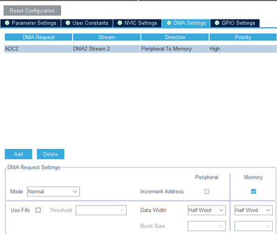

Both use identical DMA configuration but with differente DMA stream:
