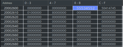

I have already confirmed using the debugger that record = 0x20002608 and latest_record_addr = 0x81ED000, and both are valid addresses. After execution, I observed that the first 16 bytes were correctly copied to the corresponding address, but for unknown reasons, the program jumps to NMI_Handler().

The first 16 bytes of memory were successfully written.
