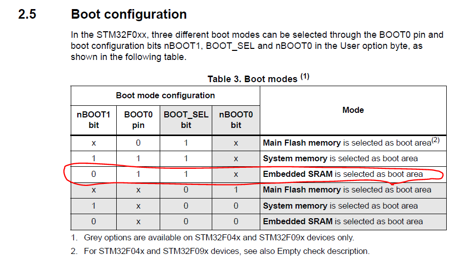

I want to move the isr vector table to SRAM
Related to this question

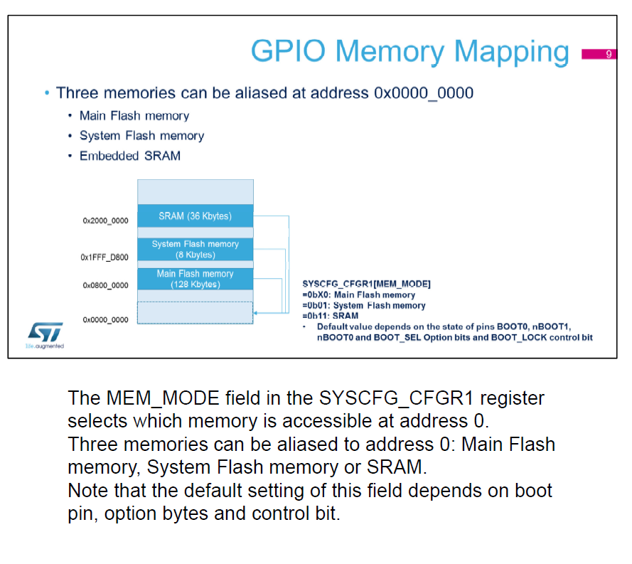

My problem is , SYSCFG->CFGR1==0 every new reboot, even if i changed to 0x03
Where can i find info about how to set SYSCFG->CFGR1 MEM_MODE bits ?
I found this so far:
2021-06-23 2:04 AM
I completely missed the info in the ref manual.
