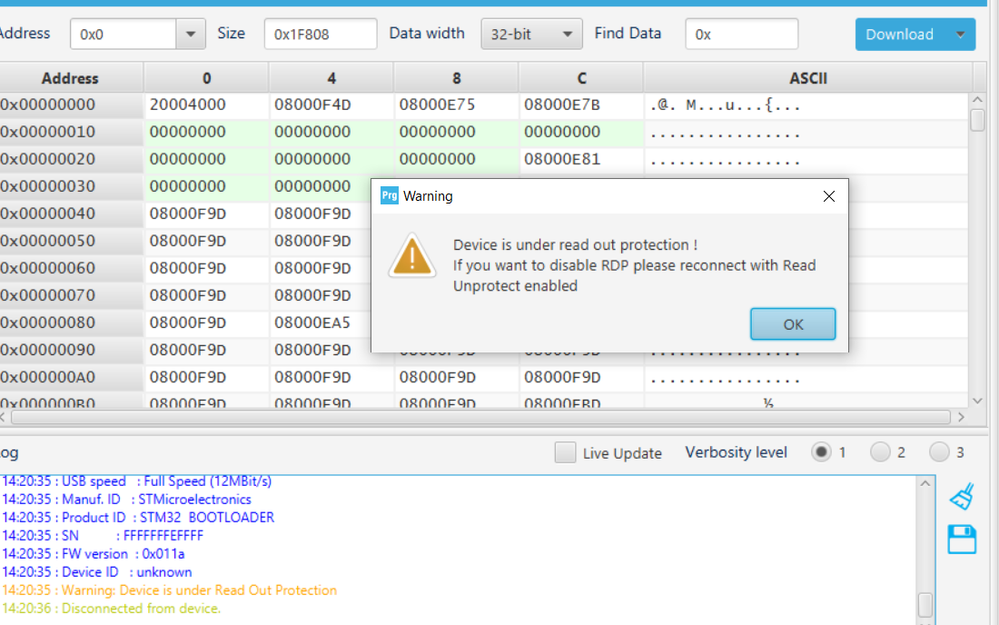

Removing the line that disables the interrupts worked. Now the STM32CubeProgrammer is able to detect the DFU device. However when connecting to it, it says the Read Protection is enabled. After connecting with the "Read Unprotect (MCU) option ticked", it says it disabled the protection. Then after disconnecting and reconnecting it gives the same error back...
Any ideas? I flashed the firmware in debugger mode for testing purposes. But I also tried in Run mode and kept the STLink disconnected.
Thanks again for your support!

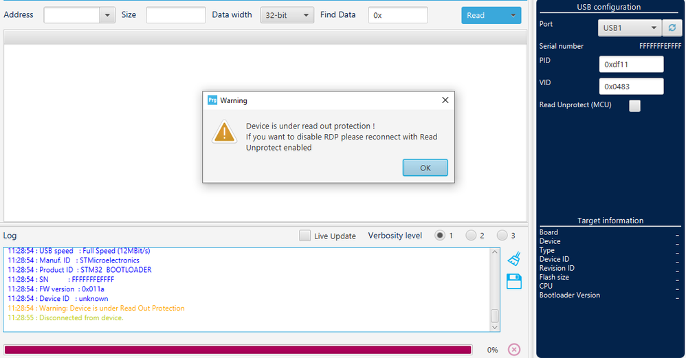

I also tried as suggested, setting up a flag to run the Bootloader_Start function after reset just before the initialization of peripherals begin.
But I still get the same issue. The STM32CubeProgrammer is able to connect but says the device is read protected:

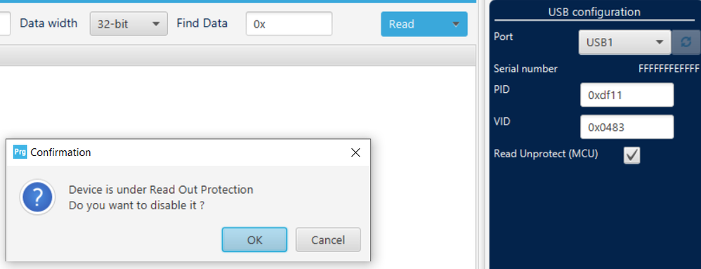

And when connecting with the "Read Unprotect (MCU)" option enabled, then I'm asked for confirmation to disable.

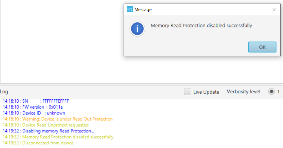

After confirmation, I get that it is disabled successfully:

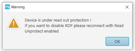

But then when I try to Download a new firmware I get the same warning saying it is under Read out protection:
Is there a way to disable this RDP during runtime before I call the Bootloader function?
