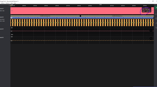

Thank you for replying to my team mate's question. Here is the code for MDIO write and read. The MCU we are using is STM32L552MEY6

Just thinking about FPGA to do this more efficiently. Just trying to understand when to make that pivot? The board contains one MCU pinging 5 PHY chipsets and reporting data over serial protocol to a GUI.

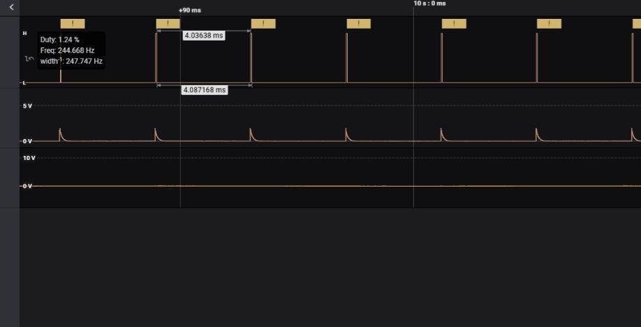

Hello Danish,
Thanks for your reply, yes have been into looking the reference manual of our particular board and thereby "SET" the BSRR reg and got pull down frequency from 2.6Mhz to 250 Hz. I know it should increase as you said earlier (by eliminating the function call for HAL_WRITE_PIN). Kindly share your thoughts on these anomalies!
0693W00000Y8RBiQAN.jpgCode:
while (1)
GPIOB->BSRR = (uint32_t) GPIO_PIN_6;
GPIOB->BSRR = (uint32_t) GPIO_PIN_6 << 16U;
Note: Just trying to toggle the GPIO pin 6 and then if it meets our requirements can implement the same in MDIO fun calls !!
regards
Sa.2
